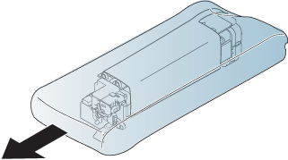

  4. Remove the new imaging unit from its package.
    [Caution]
    Do not use sharp objects, such as a knife or scissors, to open the imaging unit package. You could damage the surface of the imaging unit.

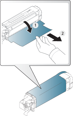

  5. Remove the sheet protecting the surface of the imaging unit.
  6. Remove the sealing tape.
