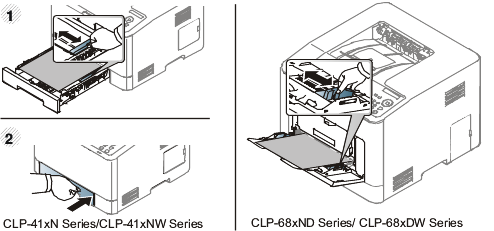

Tray overview
To change the size, you need to adjust the paper guides.
CLP-41xN Series/CLP-41xNW Series
CLP-68xND Series/ CLP-68xDW Series
  1. Tray extend lever
  2. Paper length guide
  3. Paper width guide
  4. Paper width guides on a manual feeder
[Note]
For Legal-sized paper:
Push button as shown and pull out the tray.
Illustrations on this user’s guide may differ from your machine depending on its options or models. Check your machine type (see Tray overview).

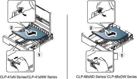

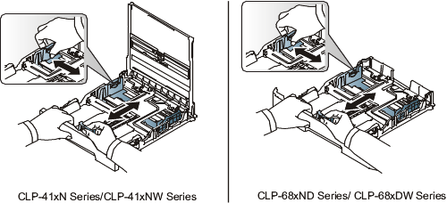

Tray 1 / optional tray
  1. Pull out the paper tray.
  2. Squeeze and the paper width guide and paper length lever to locate them in the correct paper size slot marked at the bottom of the tray to adjust to the size (see Tray overview).
  3. Flex or fan the edge of the paper stack to separate the pages before loading papers.
  4. After inserting paper into the tray, squeeze the paper width guides and paper length guide.
    1. Paper length guide
    2. Paper width guide

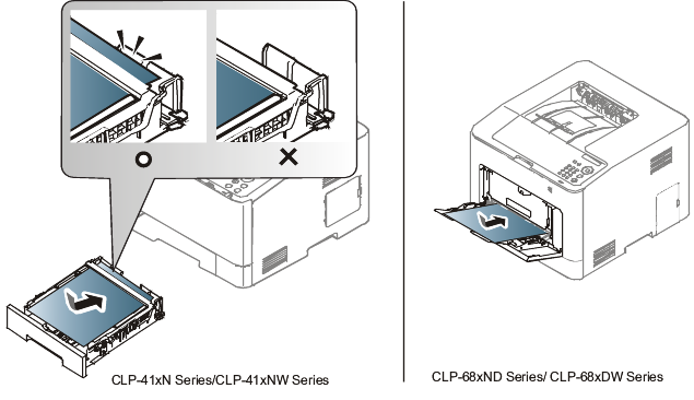

    [Note]

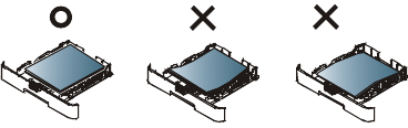

    • Do not push the paper width guide too far causing the media to warp.
    • If you do not adjust the paper width guide, it may cause paper jams.
    • Do not use a paper with a leading-edge curl, it may cause a paper jam or the paper can be wrinkled.
  5. Insert the tray back into the machine.
  6. When you print a document, set the paper type and size for the tray (see Setting the paper size and type).
    [Note]
    The settings made from the machine driver override the settings on the control panel.
    1. To print in application, open an application and start the print menu.
    2. Open Printing Preferences (see Opening printing preferences).
    3. Press the Paper tab in Printing Preferences, and select an appropriate paper type.
    4. Select Auto Select in paper source, then press OK.
    5. Start printing in application.

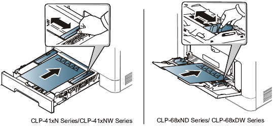

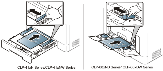

Envelope
Printing successfully on envelopes depends upon the quality of the envelopes.
To print an envelope, place it as shown in the following figure.
  • When selecting envelopes, consider the following factors:
    • Weight: should not exceed 90 g/m2 otherwise; jams may occur.
    • Construction: should lie flat with less than 6 mm curl and should not contain air.
    • Condition: should not be wrinkled, nicked, nor damaged.
    • Temperature: should resist the heat and pressure of the machine during operation.
  • Use only well-constructed envelopes with sharp and well-creased folds.
  • Do not use stamped envelopes.
  • Do not use envelopes with clasps, snaps, windows, coated lining, self-adhesive seals, or other synthetic materials.
  • Do not use damaged or poorly made envelopes.
  • Be sure the seam at both ends of the envelope extends all the way to the corner of the envelope.
    1. Acceptable
    2. Unacceptable
  • Envelopes with a peel-off adhesive strip or with more than one flap that folds over to seal must use adhesives compatible with the machine’s fusing temperature for 0.1 second about 170°C (338 °F). The extra flaps and strips might cause wrinkling, creasing, or jams, and may even damage the fuser.
  • For the best print quality, position margins no closer than 15 mm from the edges of the envelope.
  • Avoid printing over the area where the envelope’s seams meet.

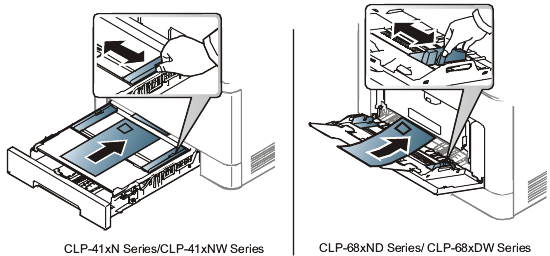

Transparency
[Note]
In case of color printing using transparencies, the picture quality would be lower than mono printing when the printouts are used on the overhead projector.
To avoid damaging the machine, use only transparencies designed for use in laser printers.
  • Must withstand the machine’s fusing temperature.
  • Place them on a flat surface after removing them from the machine.
  • Do not leave unused transparencies in the paper tray for long. Dust and dirt may accumulate on them, resulting in spotty printing.
  • To avoid smudging caused by fingerprints, handle them carefully.
  • To avoid fading, do not expose printed transparencies to prolonged sunlight.
  • Ensure that transparencies are not wrinkled, curled, or have any torn edges.
  • Do not use transparencies that separate from the backing sheet.
  • To prevent transparencies from sticking to each other, do not let the printed sheets stack up as they are being printed out.
  • Recommended media: Transparency for a color laser printer by Xerox, such as 3R 91331(A4), 3R 2780 (Letter).

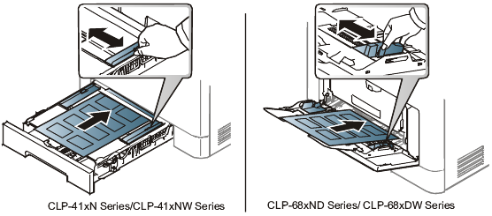

Labels
To avoid damaging the machine, use only labels designed for use in laser printers.
  • When selecting labels, consider the following factors:
    • Adhesives: Should be stable at your machine’s fusing temperature about 170°C (338°F).
    • Arrangement: Only use labels with no exposed backing between them. Labels can peel off sheets that have spaces between the labels, causing serious jams.
    • Curl: Must lie flat with no more than 13 mm of curl in any direction.
    • Condition: Do not use labels with wrinkles, bubbles, or other indications of separation.
  • Make sure that there is no exposed adhesive material between labels. Exposed areas can cause labels to peel off during printing, which can cause paper jams. Exposed adhesive can also cause damage to machine components.
  • Do not run a sheet of labels through the machine more than once. The adhesive backing is designed for only a single pass through the machine.
  • Do not use labels that are separating from the backing sheet or are wrinkled, bubbled, or otherwise damaged.

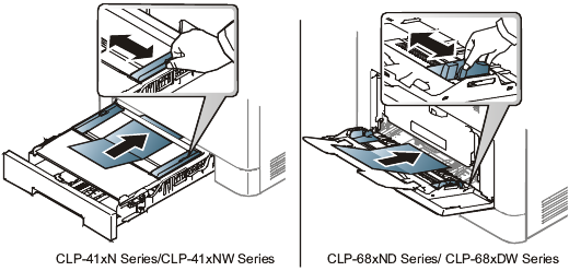

Card stock/ Custom-sized paper
  • In the software application, set the margins to at least 6.4 mm (0.25 inches) away from the edges of the material.
Preprinted paper
When loading preprinted paper, the printed side should be facing up with an uncurled edge at the front. If you experience problems with paper feeding, turn the paper around. Note that print quality is not guaranteed.
  • Must be printed with heat-resistant ink that will not melt, vaporize, or release hazardous emissions when subjected to the machine’s fusing temperature for 0.1 second (about 170°C (338°F)).
  • Preprinted paper ink must be non-flammable and should not adversely affect machine rollers.
  • Before you load preprinted paper, verify that the ink on the paper is dry. During the fusing process, wet ink can come off preprinted paper, reducing print quality.
