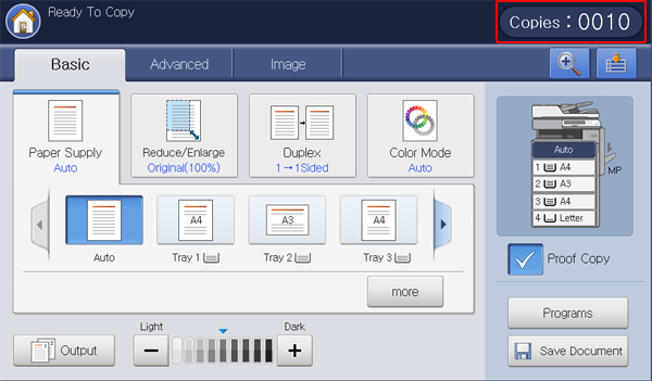

This chapter gives you step-by-step instructions for copying documents.
When you press  from the
display screen, the  screen
appears which has several tabs and lots of copying options. All
the options are grouped by features so that you can configure your
selections easily.If a different screen is displayed, press ( ) to
go to the home display screen.
) to
          : Enters the number of copies.
: Selects the paper supply tray (see Selecting the paper supply tray).
: Reduces or enlarges the size of a copied image (see Reducing or enlarging copies).
: Sets the machine to print copies on both sides of the paper (see Copying multiple sides).
: Selects a color mode for making copies (see Selecting the color mode (CLX-9252 9352 Series only)).
: Sets the machine’s various output options (see Deciding the form of copy output).
Darkness: Adjusts the brightness level to make a copy for easier reading, when the original contains faint markings and dark images (see Changing the darkness).
: Allows you to print one copy first to check the quality, then print the rest of copies later (see Proof copying).
: Allows you to save the current settings for future use (see Using a programs setting).
: Saves document on the hard disk drive (HDD) in your machine (see Saving documents).

This mode is useful when you print more than one copy. You can print one copy first to check the quality, then print the rest of copies later.
          Press from the display screen.
Place the originals face up in the DADF or place a single original face down on the scanner glass and close the DADF (see Loading originals).
Adjust the settings for each copy such as , , and more in the tab (see Changing the settings for each copy).
Enter the number of copies using the numeric keypad.
Press .
Set the copy features in the or tabs, if necessary (see Using special copy features).
Press on the control panel to begin copying.
Check the quality of the printout.
When the proof copy confirmation window appears, if you like the printout quality, press . The rest of the copies will be printed out.
If you press , the rest of the copies will be cancelled.
