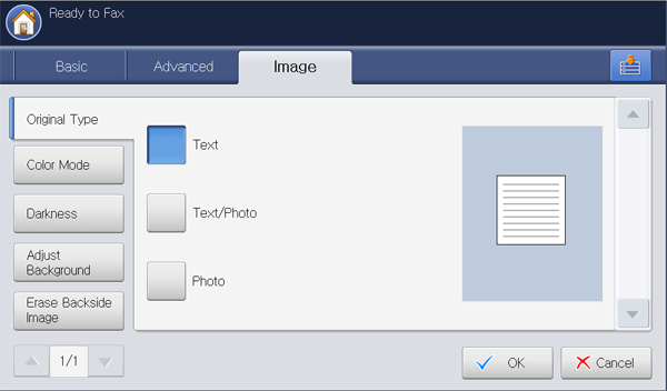

          : Enhances the fax quality based on the type of the original document being scanned (see Selecting the type of originals).

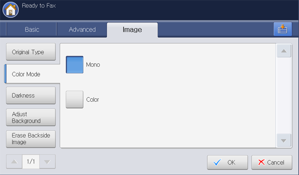

: Selects the color mode in which you want to send the fax (see Selecting the color mode).

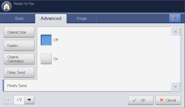

This function is used when a high priority fax needs to be sent ahead of reserved operations. The original is scanned into memory and immediately transmitted when the current operation is finished. Priority transmission will interrupt a sending to multiple destinations between stations (example, when the transmission to station A ends, before transmission to station B begins) or between redial attempts.
| ![[Note]](../common/note.png)  | |
Place the originals face up in the DADF or place a single original face down on the scanner glass and close the DADF (see Loading originals).
Press from the display screen.
Adjust the document settings in the or tab (see Adjusting the document settings).
Press the tab.
When the cursor is blinking in the input line, enter the fax number using the numeric keypad on the control panel or use from the display screen, if you have stored frequently used fax numbers.
Press the tab > .
                Press to activate this feature.
Press on the control panel to start the urgent fax job.

You can set the original document type to enhance the quality of a document being scanned.
Press the tab > from the display screen.
                Press the appropriate option.
: For originals with text or line art.
: For originals with both text and photographs together.
: For originals that are continuous tone photograph.
You can transmit a fax in color using this feature.
: Transmits a fax in black and white.
: Transmits a fax in color.
