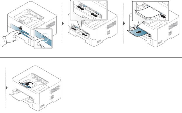

Loading in manual feeder
The manual feeder can hold special sizes and types of print material, such as postcards, note cards, and envelopes.
[Note]
Tips on using the manual feeder
  • Load only one type, size and weight of print media at time in the manual feeder.
  • If you select Manual Feeder for the paper source in your software application, you need to press Print screen or Configuration page, or WPS button each time you print a page and load only one type, size and weight of print media at a time on the manual tray.
  • To prevent paper jams, do not add paper while printing when there is still paper in the manual feeder.
  • Print media should be loaded face up with the top edge going into the manual feeder first and be placed in the center of the tray.
  • To ensure printing quality and to prevent paper jams, only load the available paper (see Print media specifications ).
  • Flatten any curl on postcards, envelopes, and labels before loading them into the manual feeder.
  • When printing on special media, you must follow the loading guidelines (see Printing on special media).
  • When papers overlap when printing using the manual feeder, open tray 1 and remove the overlapping papers then try printing again.
  • When paper does not feed well while printing, push the paper in manually until it starts feeding automatically.
  • When the machine is in a power save mode, the machine does not feed paper from the manual feeder. Wake up the machine by pressing the power button before using the manual feeder.
