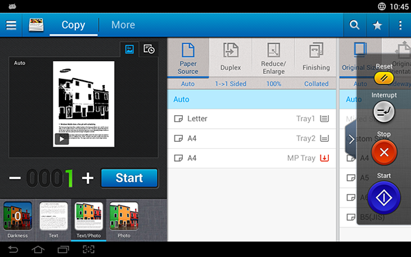

Understanding the copy screen
When you tap Copy from the home screen or Apps , the Copy screen appears. This screen has several tabs and many copying options. All the options are grouped by feature so you can configure your selections easily. If want to go home, tap the home() button.

Command keys
Button
Name
Description
Quick Menu
Open the quick menus.
Search
Search for a desired menu or app.
My Program
Add an app to My Program List.
Sub menu (Action overflow)
Open the sub menu.
Set the number of copies printed.
Virtual Hard Key
[Note]
  • Virtual hard keys are located on the right side of the screen.
  • When an app is launched for the first time, the virtual hard keys are shown.
  • If the screen is touched, the virtual hard keys always appear.
  • If the , touched, the virtual hard keys are hidden and shown.
Button
Name
Description
Reset
Reset the current machine’s configuration.
Interrupt
Suspend the current job, allowing for urgent copying.
Stop
Stop a job at any time. A pop-up window appears to show the jobs that you can stop.
Start
Start a job.
Copy tab
Preview
Display the originals type.
Button
Name
Description
Setting History
View changed options list.
Preview for status
Shows the job preview.
Preview for play
Scans for job.
Preview edit mode
This button appears to edit when scanning. Adjust the prescanned image with operation functions such as rotate and crop.
[Note]
Some features are not available to preview edit mode.
Start
Starts a job.
