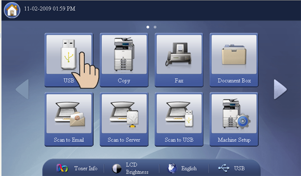

To use the USB feature, press on the display screen.

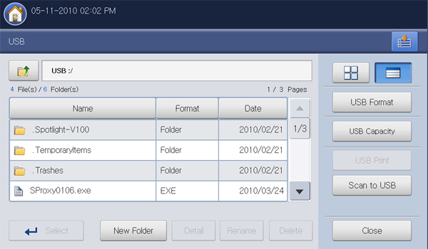

         Moves back to the upper level.
: Moves to the selected folder.
: Makes a new folder in the USB memory device.
: Displays information of the selected folder or file.
: Changes the name of the selected folder or file.
: Deletes the selected folder or file.
 You can choose the layout for viewing the folder structure in
folder view or list view.
: Formats the USB memory device.
: Displays the USB memory status.
