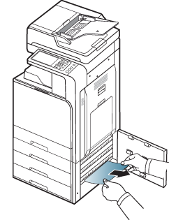

Paper jam inside the machine (Jam feed 1)
[Caution]
The fuser area is hot. Take care when removing paper from the machine.
  1. Open the right door.
  2. Remove the jammed paper by gently pulling it straight out.
  3. Close the right door.
Paper jam inside the machine (Jam feed 2)
  1. Open the right bottom door.
  3. Close the right bottom door.

  1. Open the right bottom door of the Triple Cassette Feeder.
  3. Close the dual cassette feeder right bottom door.
