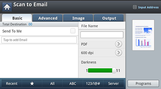

Press Scan to Email in the display screen.
Basic tab
  • Send To MePress the Advanced tab > Email Settings, then type the sender’s email address. Click the checkbox on the right to send to yourself.
  • Input AddressTap the screen to add recipient’s email addresses.
  • File NameMakes the file name for the file to be sent.
  • File FormatSelect the file format before you proceed with the scanning job.
  • ResolutionSelects scanning resolution value.
  • DarknessAdjusts the degree of darkness of scanned output.
  • Address Book(()Favorite, All, ABC, 123/!@#): Inputs the recipient's address by pressing stored addresses. You can save frequently used email addresses using the control panel or SyncThru™ Web Service (see Setting up an from the control panel or Setting up an address book from SyncThru™ Web Service).
  • RecentShows the latest email addresses used. Also, you can choose email addresses instead of pressing the pop-up keyboard (see Resending to the last email address).
  • ProgramsAllows you to save the current settings for future use (see Using a programs setting).

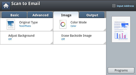

Image tab
You can move to the next or previous page using the up/down arrows located at the bottom left.
  • Original TypeSelects whether the original is text, photo, etc.
  • Color ModeAdjusts the color options of scanned output.
  • Adjust BackgroundErase the background to some extent by adjusting density or brightness.
  • Erase Backside ImagePrevents scanning the other side’s image shown through the original paper.
  • Scan to EdgeScans the document all the way to the edge of the paper.

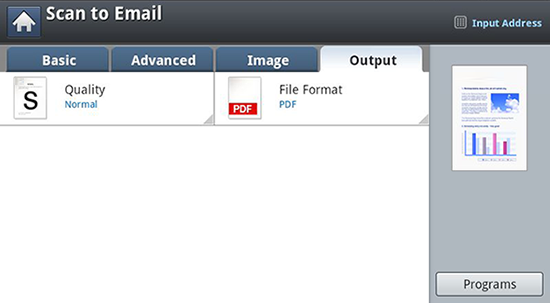

Output tab
  • QualityAdjusts the display quality of the scanned output.
  • File FormatSelects the file format for the file to be sent.

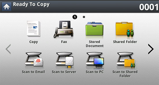

  1. Place the originals face up in the RADF or place a single original face down on the scanner glass and close the RADF (see Loading originals).
  2. Press Scan to Email from the display screen.
